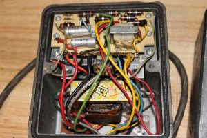

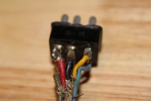

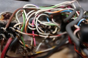

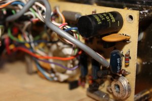

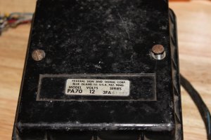

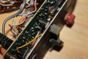

I found this Whelen WS-295 siren while cleaning out junk in the fire station. My Chief wants to hold on it thinking at some point we could put it back in service or as a backup should a siren unit...

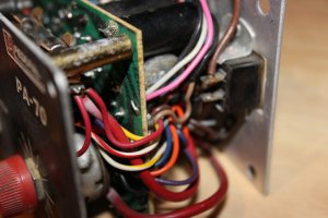

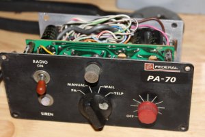

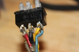

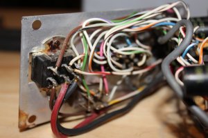

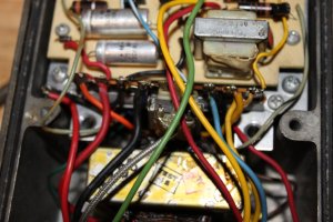

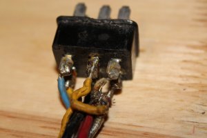

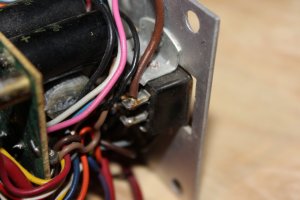

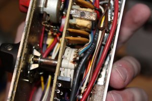

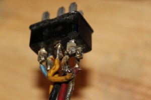

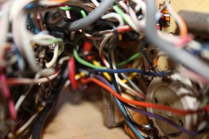

Here's a bunch of photos of both the siren controller and the amp itself. Upon further diagnostic testing, I found that the siren-to-controller cable harness is messed up. You can see in the...
