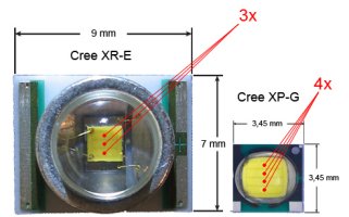

Cree XR-E
[Broken External Image]:http://www.cree.com/~/media/Images/Cree/Components Modules/XLamp/XRE White/XRE_Cool_Angle_med.jpg
This is used by many companies and is still popular today. This replaced the star based in some regards because it was more efficient power wise and since it flow solders to the board it was heatsinked better
I can change these but its more expensive. It is $5.00 per diode changed. Ie a lin6 with these diodes would be $30.
Cree XP-E
These little guys are mainly found in whelen heads. They are about the size of a framing nail head.Primarily in the justice style heads like the newer con-3s and the LR-11 takedowns.
I can change them but the limited use of this diode makes it more expensive at $6 per diode changed. As noted though I CAN make colored lr-11's
Comparison between the xre and the xpe
Philips luxeon rebel
Luxeon rebel size comparison
Size comparison to xp
[Broken External Image]:http://www.msc-ge.com/en/6817-www/version/default/part/ImageData/data/cree_xlamp_xp-e_white.png
This is the newest diode on the market today. This bad boy are bright but they are also a pain. Your big companies like whelen and feniex use this series. Whelen has been the first one to be utilizing those diodes which has been proven detrimental, there was a process problem at philips which led to hundreds of thousands of these diodes to fail prematurely due to bad epoxy.
I can change these as well but for the size and work it takes the price reflects that at $6/diode. Ie a lin6 with these diodes would be $36

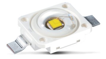

Its the OSRAM led
This diode was popularly uses by sound off signal specifically the led3's. This was on my could not do list but I have successfully done a few for myself so I'm opening it. So yes I can do led3's now
$5 per diode. Ie led3 changed would be $15.
