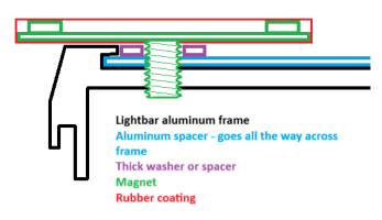

I have a responder HD that I would like to put magnets on. It has the carriage bolt channels so just needing to figure out what a good magnet would be. No clue what the factory # rating is and...
I forgot to link the source of the magnets. He's out of Canada and I get all of my magnets for mag mount projects from him. I also forgot to mention I converted a 24" FS Legend into mag mount with...
Hello, Jennifer! Here's mine. This is a bit barbaric as it was a quick and dirty build I needed for a project I was on, but it works. These magnets are 3" diameter all stainless discs with...
